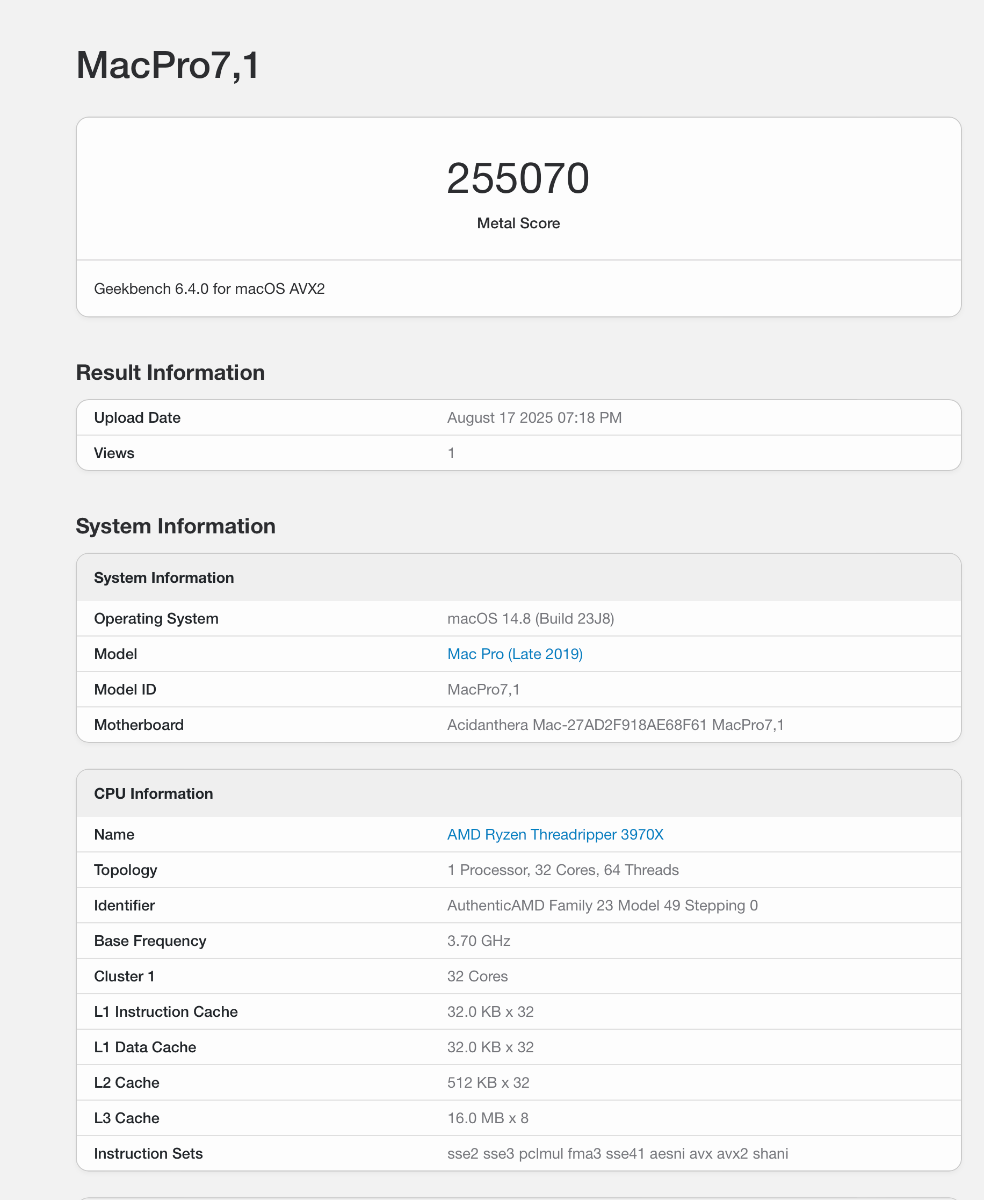

just tried tests on Geekbench v6
not crazy powerful compared with new Mac but as I use my rig on windows and macOS, with Nvidia cards for windows etc etc,
it is more 4 wheels drive rig than sport rig :-)

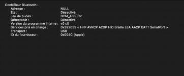

I guess I have new problems,
i had bluetooth ok for a while then after a reboot= FINITO
I join 2 screens if someone has an idea
iadded some kexts not activated
i have a tr40x aorus so intel wifi bluetooth
cheers

The order in which the Bluetooth kexts are loaded in your OC config.plist makes a difference to if and how the Bluetooth device works, or not.
I use the following order for the 3 x kexts when using an Intel Bluetooth device.
  1. IntelBluetoothFirmware.kext
  2. IntelBTPatcher.kext
  3. BlueToolFixup.kext
You need to make sure the USB port associated with the M.2 connector, which the Intel WiFi/BT card is connected through, is enabled and configured with the correct USB connector type in your USB configuration kext, I.e. set as ‘Internal’ (255).
After changing the order of the BT kexts in your configuration.plist, make sure to use the ResetNvram option from the OC boot screen.

I answer to myself if someone find this topic and has same troubles
to resume my trouble was ONLY BLUETOOLFIXUP in 2.7.1 version instead of version 2.6.8
the reason according to chatgpt after asking why it is not working with 2.7.1
BlueToolFixup 2.6.9 is generally fine on Sonoma 14.x, like 2.6.8.
• 2.7.0+ changes behavior and requires specific NVRAM variables; without them it often fails.
Factual conclusion:
• On Sonoma 14.8, use 2.6.8 or 2.6.9 if you are not setting the required NVRAM variables.
• 2.7.x works only when those variables are correctly present.
i restarted from scratch with my EFI working on 14.3.1 and changed each kexts or upgrading each .efi one by one to find at the end that it was this one which is the problem
right now I am at the last version in opencore and all the kexts EXCLUDING BTOOLFIXUP staying at
