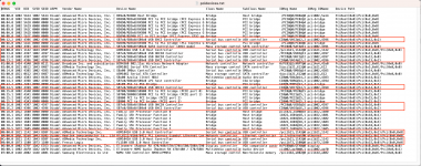

hello I can't find XHC in the DSDT as indicated in the hack
Your DSDT.ml may not contain an XHC device.
It is an old system. So it may use a different names for the USB controllers. You are also likely to have a system with multiple USB controllers.
For example my Asus Sabertooth FX990 R2.0 has 3 xASMedia USB controllers, 3 x EHCI USB controllers, 3 x OCHI0 USB controllers and 1 x OCHI2 USB controller.
The ASMedia controllers work Out of the Box (OOB) at USB3 and USB2 speed (5 Gb/s & 480 Mb/s)
The EHCI and OCHIx controllers only work at USB1.1 speed (12 Mb/s), which is fine for mouse, keyboard or Webcam. But rubbish for anything requiring faster connection.
Because of this I have installed a USB PCIe card that provides 5 x external USB3 ports and a 19-pin case front connector. This card uses a Fresco Logic USB controller (FL1100), which works out of the box in macOS.
Have a look in Hackintool > PCIE devices tab to see which USB controllers are present in your system.
A copy of the pcidevices.txt from my Sabertooth system is attached below, with the USB controllers highlighted.
Your motherboard is of a similar age so will probably use similar USB controllers.
