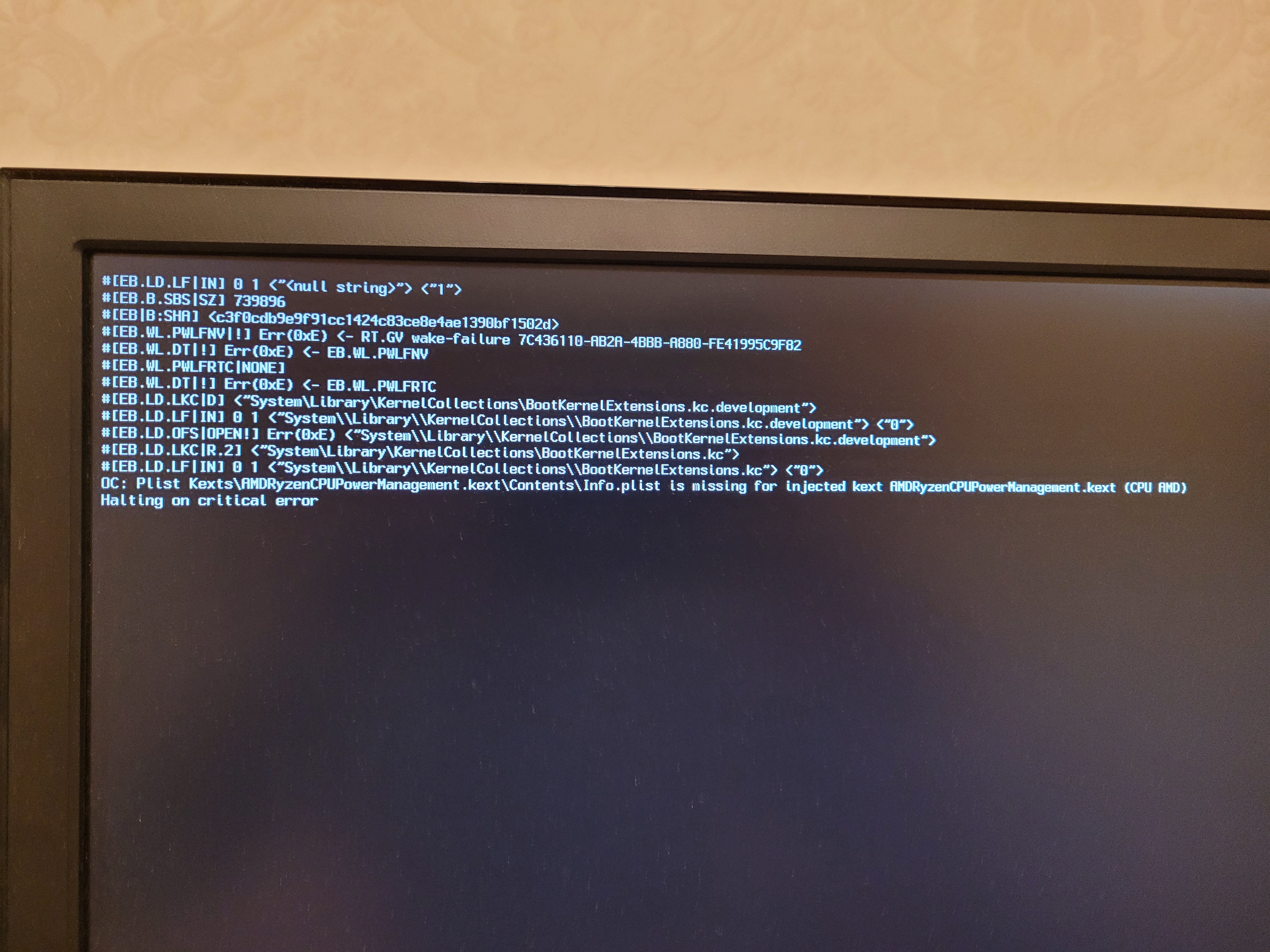

Constantly reboots after the second stage of the boot
What GPU and what NVMe drive?I have the same cpu as your 5900x
Did you remove agdpmod=ignore from the boot arguments?asus strix vega64
ssd adata xpg gammix s5 2tb m.2 nvme
bios settings laid out on page one
Have you made any other changes to the EFI or added anything else kext, driver or SSDT wise?all done
I see what's wrong now, You have lost Kernel info for one of the kexts.I'll try to install it tomorrow. thanks anyway
only config.plistHave you made any other changes to the EFI or added anything else kext, driver or SSDT wise?
OKI see what's wrong now, You have lost Kernel info for one of the kexts.
Whatever your using to edit the config.plist with is messing up the config that's if its not you doing it.
Download the EFI again and add your SMBIOS details, Remove the boot argument and don't do anything else and try again and use PlistEditPro or Xcode to edit the Config with.
PlistEdit Pro
PlistEdit Pro is a handy little tool to edit your Config.plist with among other things.forum.amd-osx.com
In the first screen shot you sent the kext info is missing and in the second screenshot you sent it looks like your installer is locked.OK
I'll do it tomorrow and let you know. thanks again
