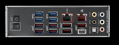

The motherboard has two Ethernet ports on the Rear I/O plate, have you made sure you have the Ethernet cable connected to the 2.5GB Ethernet port?
Screenshot 2024-02-07 at 22.31.10.png Rear I/O plate from ROG Crosshair VIII Hero motherboard, 2.5GB Ethernet port highlighted in RED rectangle.
The Other Ethernet port uses an Intel i211-AT controller and unlikely to work in macOS.

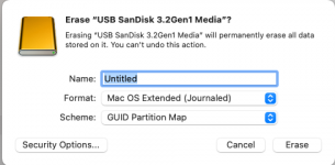

Second, I would look to recreate the macOS USB installation drive. By that I mean the following:
  1. Delete the macOS Installation app you perviously downloaded to create the USB installer.
  2. Download a new macOS App using Corpnewt's GibMacOS script - https://github.com/corpnewt/gibMacOS
  3. Erase the USB drive using Disk Utility, as shown in the screenshot below.
    1. Screenshot 2024-02-17 at 18.33.50.png Disk Utility - Erase options for USB
  4. Then use the following terminal command to restore macOS Monterey to the USB.
    1. sudo /Applications/Install\ macOS\ Monterey.app/Contents/Resources/createinstallmedia --volume /Volumes/Untitled
  5. Then add the EFI folder to the EFI partition on the USB.
  6. The USB should now be ready for use.
