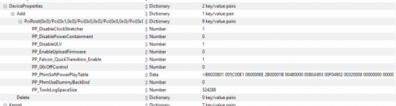

When using NootedRed.kext you can't have any devices entered in the DeviceProperties > Add section of your config.plist. If you do have any entries these are likely to cause the system to kernel panic.
Screenshot 2024-08-05 194618.png These DeviceProperties need to be deleted from config.plist.
PowerPlay entries are not needed for your APU.

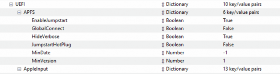

You have the wrong entries for UEFI > APFS > MinDate & MinVersion config options. These should both be -1 or 0 if you are running any version of macOS newer than Catalina.
Screenshot 2024-08-05 200542.png MinDate is fine but MinVersion is wrong.
Setting both to 0 would be my choice.
