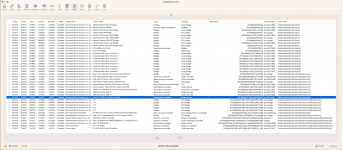

Not sure you are correct, as there is an entry in the DeviceProperties setting layout-id=3, see highlighted section in image below.
Capture d’écran 2024-07-03 à 20.32.32.png Is this DeviceProperties > Add entry still present in your config.plist?
View attachment 14474 Is this DeviceProperties > Add entry still present in your config.plist?
yes this entry is still present I tried the proposed arguments nothing has changed
I updated kexts

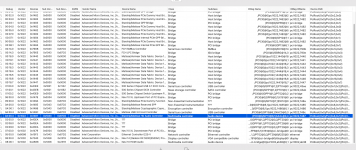

What does Hackintool > PCIe tab show as being the Device Path for your AMD Audio Codec?
This is what my Asus B550M system shows for the Audio Device.
Screenshot 2024-07-03 at 21.17.26.png AMD Audio Device highlighted
Similar but not identical Device Path to the one used in your config.plist.
Just make sure you are using the correct Device Path if you are relying on DeviceProperties to enable the Audio.
