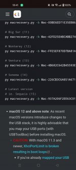

I was using dortania said lasted version
Well I'll ask again what version of macOS are you trying to install? Ventura? Sonoma? Sequoia? Whichever one I explained Whatevergreen.kext does not work with your system but you are still using it.
I'm trying to install sequoia and i did realise that and removed but still gave me the same error
